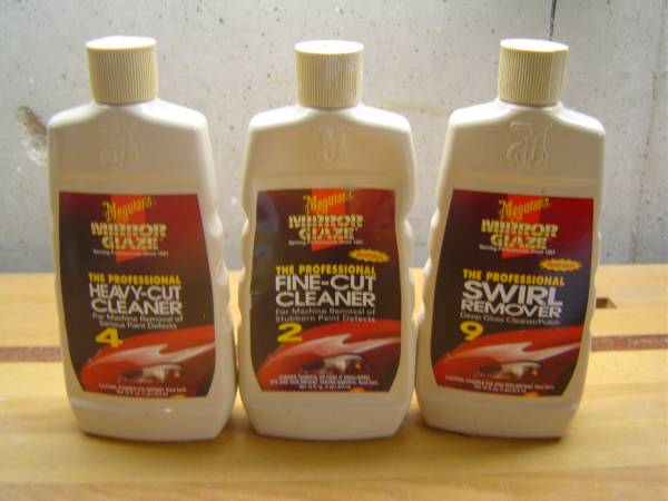

Here is the maguires I use and as you can see the numbers dont necessarily indicate a finer grit compound.

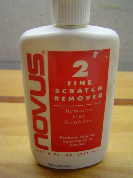

Also, Novus works well even on french polishes.

Look at the chart on the back of the bottle it has a graft showing the grit rating. put it on you finger and fell it is noticble. I could be thinking backwards but I dont believe so. The #7 is a glaze intended to use to buff out a finish to high sheen. #9 is swirl remover intended to remove oxdidation and shallow swril marks and scratches. If I am wrong I will stand corrected and set in the corner and pout
If you look at you posted pic notice ther is no relationship between the grit and the product #. My guess is the number is just the order they released the product.MichaelP38518.4149305556
